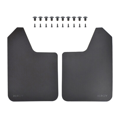

Where did you get these from? My OEM copies have failed and I'm looking for alternatives.
Ebay, used some different clips though and needed a slight trim on the inside edge, just held them in place, drilled 9mm holds and pushed some 2 part bodywork trim clips in, feels quite solid.

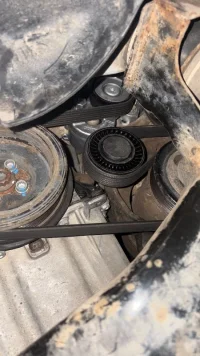

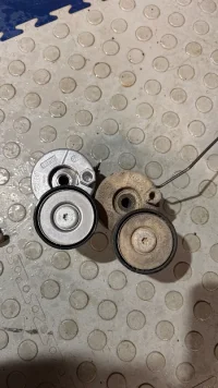

Haven’t had a chance to road test it yet, but it’s nice to hear another ‘cured the whistle’ after tensioner replacement.
I wouldn't have called it a low frequency whistle though, pretty high frequency and noticeable at all speeds...
