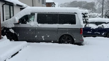

Had to re-align my wipers.
Driving along and put the brakes on at a roundabout and all the snow came off the roof while the wipers were going and magically managed to make one wiper cross over the top of the other one as I rapidly tried to turn them off.
So I ended up with crossed wipers.
Anyway, a bit of fettling and they are back where they should be and seem none the worse for their experience.

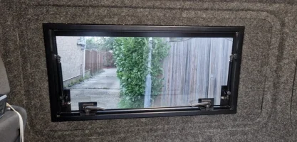

Insulated the glass (12mm thermo liner pro) around the safari window opening before...

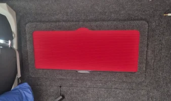

Purchased some rubber to use as a drawer liner at Busfest and for some reason left until the extreme colder months to cut to size and fit. Also a 2 second job to declutter the windscreen. Removed the Driver Assistance sticker and relocated in glovebox.

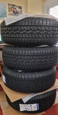

Not today sorry but in-between crimbo n NY I fitted some 17” Rogue Rampage+ with Michelin Agilis cross climates. I have been running 20”s with HnR 40mm lowering spring and was fed up with the harsh ride and pot hole dodging. I camp a lot in my van and hopefully this will allow me to use it more in the winter months too. Next in the list some Renogy goodies and hun caps...!
Nothing on "the" van today but had the new boots turn up. New breakfast bar in the dinning room :fast rofl:
Needless to say they have now been relocated and spent the evening giving the a good scrub with some isopropyl and gave them there first coat of some new fangled graphene ceramic coating for alloys. Im still not convinced on these coatings but if it saves me some elbow grease in the future, they are getting at least 2 applications because I'm really not looking forward to having to clean these!
Excellent choice!
What wheels?
And 100% get them ceramic coated whilst they're off the van, I used Gtechniq C5 wheel armor - 2500 miles worth of road grime and baked on brake dust came off with ease after my 3 week euro trip.

Excellent choice!
What wheels?

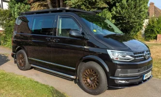

As for the rims.... Watch this space, van needs a wash before I fit them but not going to lie.... they have well and truly exceeded my expectations :cool: (then again I'm biased:slow rofl: )

Yeah I recognised the tread pattern, and the tyre shape!!
2-3 years is pretty standard for a wheel ceramic coating that stuff looks good.
A good set of wheels can make a car/van, glad you're happy with them!! :cool: :D
Stock suspension (t32 at a guess)?? Edit, scrap that, I was reading your build thread the other day around the Mountain bikes.... loving your work! Quite local to me too!
