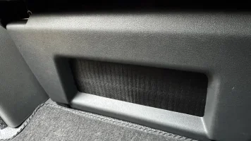

Do you want the dims for the double or single seat version?Do you have the dimensions to hand? Thank you
ok thank you you’ve not seen them close up but I’m happy with themBoth if you don’t mind. I have plastic containers under there at the moment but what you’ve done looks very professional.
Ok guys here’s the double seat box I hope they make sense, I don’t know how to do drawings on my iPad so I’ve done this.Any questions feel free to ask.Both if you don’t mind. I have plastic containers under there at the moment but what you’ve done looks very professional.

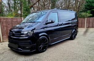

I know there is a bit of a filter going on here but..... dam, i like that yellow!
The vip members badge will go with it a treat! Beautiful van!Thanks. We’ve only just got it and love it.
Karen filtered it a bit but not far from the correct colour.
Ok guys the two seater box has had thumbs up so I take it’s readable so here’s the single seat version.This one has to be put in place with the seat tilted forward as it won’t slide in from the front due to the cut out where the seat base sits in the slot and does not slide out.Any probs give me a shoutOk guys here’s the double seat box I hope they make sense, I don’t know how to do drawings on my iPad so I’ve done this.Any questions feel free to ask.
I started with the base ,fixed the front and back on top of the base then the ends all glued and pinned with nail gun and clamped but pins would suffice. I added 1”square baton to the front sides and base screwed for extra strength.If you can understand these dimensions I’ll do the single seat box.Just an fyi I would check for fit before covering ;-) enjoy Padders

Am I right in saying you don’t have the OEM rubber mat so the measurements for the height will be different?
Not at the moment mate it should be here from Germany any day but I’ve allowed for the mat in the height but check before you cover the boxes I’m sure they’ll be fine.Keep us updated how you get onAm I right in saying you don’t have the OEM rubber mat so the measurements for the height will be different?
