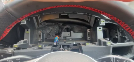

Have been tinkering away and decided to fit the dash thats been sat on the side for a while.
Pulled the stock H/L one out and its certainly showing that it spent a fair bit of time in stables in a previous life (needs a clean behind here, lots of dust)

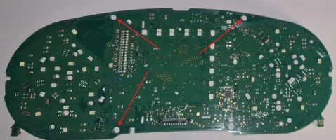

I didn't like the way the original dash PCB was sitting in the LCD housing (it was twisting the PCB when tightened) so made some better fixings for it (all of 10 mins in onshape) and a few iterations later have a perfectly supported PCB with no fouling or twisting also protecting it from the screws themselves.
Raises the PCB by 1.5mm and locates properly in the PCB mounting holes.
Spent waaaaaaaaaaay to much time tinkering in the new dash menus (vs working). Lots of oooooooooooooo going on!
Just need to run a quick scan post install to check all is well and re-fit all the trim :-)
View attachment 268454View attachment 268455
Just need to run a quick scan post install to check all is well and re-fit all the trim :)

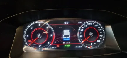

Ok, I couldn't resist it, still need to do a scan and reprogram some adaptations it's reset but.....
It's soooo pretty!
Really should have done this sooner!
It's been sat on the side for the last 2 and a bit months!
Aside from randomly calling people by accident while playing with the settings (swiftly disabled Bluetooth after placing 3 calls) the adaptations that were reset were (ones i have noticed so far at least):
  • Door locking / unlocking - Can be reprogramed via the new dash
  • Courtesy entry/exit headlights- Can be reprogramed via the new dash
  • No indicator flash on lock / unlock - cant be done via the dash but can enable lock / unlock alarm chirp
It's soooo pretty!
