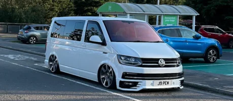

Keep it that low, looks superb!Fitted the new wheels and tyres!
Temporarily a member of the 'swamper low' club...![]()
Did a test drive of multiple conditions and I was half expecting it to be rubbing loads, but... Barely anything!! Some at the front on full lock, and once in 30 miles over a big wallowy bump, some very light rubbing at the top.
Otherwise, all fine! By the way, that's 245/65R17's at 390mm ride height at the front, or 70mm lowered than stock!
I think the profile of the falken wildpeak helps, they're very rounded on the shoulders - a BFG K02 with it's much squarer profile would rub a lot more. Also my mega firm suspension helps with there being not much suspension travel! The tyres have maybe reduce 5-10% of the harshness, not a lot, if any.
Speedo is 2mph out at 50 - 48mph on cruise equals 50mph GPS. On the old wheels 52mph would equate to 50mph. So it's 6-7% different which is as expected.
As you said, very little catching! Perfectly fine for the trip up to CRS on Wednesday/Thursday to get my suspension upgraded!
Oh and did the pressure trick someone on here posted, 46psi cold, after 40 mins driving up to 49psi so that's almost bang on.

If went lower than standard but higher than it currently is, with actual comfortable suspension, I think it would rub more as there would be more travel than it currently has. It's only because it's hard as hell that it's not rubbing.
So, upwards it is! Comfort is the number 1 priority.
Pretty much the gold standard - Koni Special Active Shocks, std springs, and possibly 25mm lift spacers. Then H&R anti roll bars - hopefully these will reign in any roll with the van going about 90mm higher than it currently is!So what are you having fitted @CRS Performance ?
Sounds good…. Steve’ll look after you. I totally understand and appreciate your priority of comfort…. it’s something I’m possibly thinking about for the future!?Pretty much the gold standard - Koni Special Active Shocks, std springs, and possibly 25mm lift spacers. Then H&R anti roll bars - hopefully these will reign in any roll with the van going about 90mm higher than it currently is!
I'll have extra weight up top in the form of a roof rack too.
Oh and rear discs and pads. I had a quick look while I had the wheels off today and there's about 5mm of pad left so probably another couple of thousand miles - but I've got three weeks off in late September and will probably do a euro trip of 1500-2000 miles so I'd rather not get down to the metal on the trip!
Just looking at how much space there is between the tyre and the arch liner where it rubbed once - I reckon there's about an inch, maybe 1.5inches. which means I'm basically got 1.5inches or less usable travel on the front. Which is why it feels rock hard!
