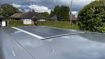

Yesterday and today, finally got my solar panel bonded to the pop top. Renogy 200W bonded with Sikaflex 552 to a layer of clear PPF so it will be easier to remove if (when!) I need to. Left a 3-4mm gap below the panel to give some ventilation. Cables route through a Scanstrut gland outside the tent and route into the van via the cable grommet on the top left of the tailgate. Really happy with the result. Giving 150W ish with the roof down at 4pm, so not direct sun. The Scanstrut is fantastic and definitely worth the extra few pounds. It’s very small, beautifully made, easy to fit and I have no worries that it will be totally waterproof for many years.
