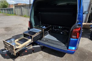

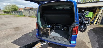

Window bags fitted!
There's more of a gap the top than I thought there would be, but that's to allow for the California plastics - the caravelle headlining/plastic trim is smaller I think.
I'm presuming these will be fine with a Shuttle too? A good storage solution for clothes etc, much better than having to live around soft bags which is what I do at present. I cope with it when solo travelling, but if there's 2 of us it gets awkward.
Have you got the pull up blinds in the shuttle? They sit behind the hooks for that, or the blinds that pull down in the California.
If you've got these, I think they'll fit, as the lower plastics would be the same.

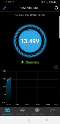

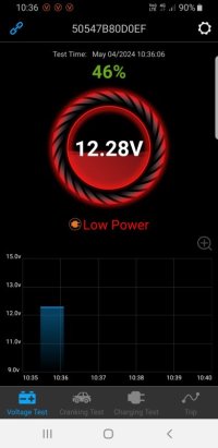

Firstly, bought a BM2
Crimped in a fuse holder
Took off the top fuse cover
Attached the monitor to a spare post, and whilst I was there, put the NoCo lead on the other spare. Negative for the BM2 to the battery clamp, NoCo to the wing where I was previously using a short length of cable to clamp to.
Better reading than I expected, as my tracker was showing 12.1v
And plugged in the charger
Looks good to me anyway
