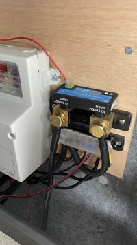

Not today but yesterday, fitted the Victron Smart Shunt I bought from @RunDSG. Top chap for dispatching really quickly - thanks :thumbsup: . Great bit of kit so I can now see what the battery (Fogstar Drift 105ah) is up to in the same app as the DC-DC, MPPT (when I fit it!) and iP65 smart charger. Just need to wire the (slowly dying) starter battery into the aux on the shunt so I can keep an eye on that too without needing to use the BM2 app. Also fitted a switch to the DC-DC so I can turn that off and will do the same for the Amblemail AMT12-2 so I can control when the starter battery is being trickle charged.
(work in progress so wiring needs tidying up).
