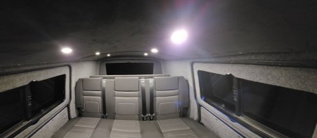

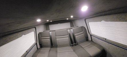

It's IKEA Hopvalls blind. There's a guide on you tube on how to shorted them - this is a 1m blind cut down to 900mm. The main body of the blind is held at the top with 3 self tappers through the ply door skin. The blind runs in carpet lined pvc cable ducting, velco'd to the back of the panel.
The handles I've cut from ally plate.
The door panels I made myself and are screwed onto the door frame - wish I'd fitted the blinds before assembly!

you have done a fantastic job there! van shade look for ikea price!!

On a serious note, the blinds look fabulous, you have a campah mate! I have some internal carpety internal windscreen and driver/passenger blinds you are welcome to borrow if you don't want to spend any more!
