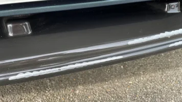

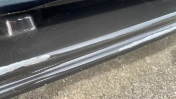

Took off the front splitter this morning to give Alan @Alan@Crafted automotive a little bit of work to do in the next few weeks.
Not quite on the scale of @Texxaco 's Floyd front end, but an improvement non the less. :thumbsup:
It looks like the lacquer has started to delaminate from the abs plastic or whatever the term is in body shop jargon!!

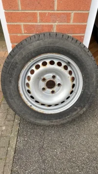

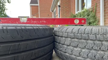

Then, decided to swop out the original 16" steel spare with brand new M+S winter tyre for a 17" wheel / tyre combo with a just legal tyre.
This is so 340mm brakes can be fitted by @CRS Performance some time early next year.
The 16" rim does not fit over a 340mm caliper, whereas a 17" does.

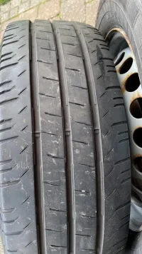

Original, as supplied by Vw wheel / tyre 16" combo

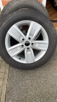

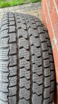

To be fitted, as received from a kind fellow T6F member (@Bear) after meeting up at a former Brook Meadows summer camp a good few moons ago.

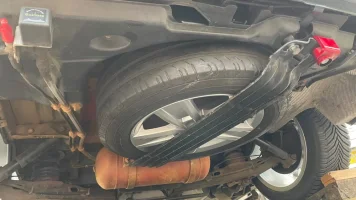

The, to be fitted 17" wheel with standard 215/60/17 tyre was slightly deeper than the 16" wheel / tyre and the wheel carrier was on its highest setting from the factory.
Thought it would be ok not to alter & drop the carrier height just for 10mm
Although tight, everything fitted ok, but I certainly wouldn't want to drop the spare & change a wheel at the side of the A1 on a cold, dark, wet, wintery night.
Took also a little time to liberally spray some anti rust goo around the wheel well & everywhere else until the rattle can was empty:
