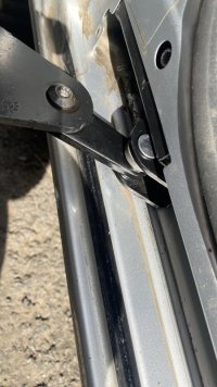

Swapped out the bottom door roller with a collapsed bearing for a shiny new one. Not genuine, but a Febi Bilstein which seems really good quality and same size rollers etc.IMG_5055.webp
Took about 10 minutes to do. Took me longer to find my spline bits than to do the actual swap.
Top tip, the bracket is on slotted fittings so draw round the 2 bolts with a sharpi or similar before removing them. You can clearly see the pen circle on the door arm in the pic.
was your sliding door catching on the rear arch?
No, the bottom roller bearing disintegrated so the triangular metal piece of the runner was sat on the metal of the van with the roller no longer present. To open the door without lifting would have caused metal on metal - which it did once and put a small scrape in the metal base of the van before I realised. If that makes sense.
