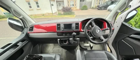

I cleared a P060600 fault which was causing a yellow engine light on dash. It came about not long after the Apple CarPlay was playing up, which was shortly after daughters phone with a dodgy Lighting connection port disconnected itself from the USB. All working fine now.
I’ll have to do it all again as at some stage I want the black Lower dash trim and door card upgrade
It's damn sticky stuff isn't it. Hopefully makes a difference too.
When you get all your lower dash panels do those too. I have. Similar to the California.
Ironically my panel van had the factory deadening on the original door cards and glove box. They don't tend to get that now. Even the california door cards I've fitted didn't have anything on them!
