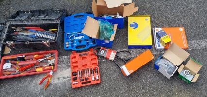

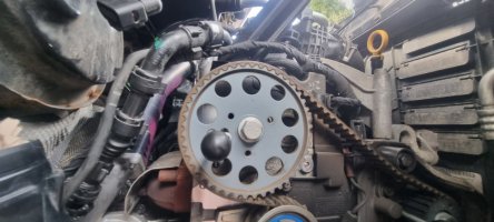

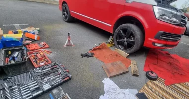

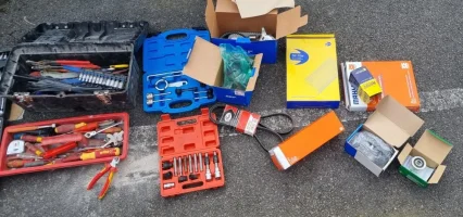

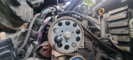

Last Sunday I have replaced the following:
- front brake pads
- intercooler rubber mounts
- engine oil
- filters(oil, air, fuel & cabin)
- alternator overrunning pulley
- timing belt & coolant pump
And I am not happy cause I was hoping to also get my DCC front shock absorbers installed :confused:.

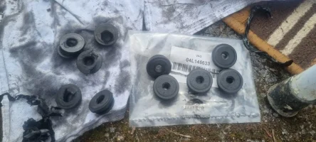

@Robert are the intercooler mounts normally wearing that badly? If so what is the milage on yours?
Yes, they do as my example proves.
Even though my engine has balancing shafts vibrations on the top of the engine are quite significant.
