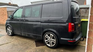

Resisted the temptation to wash the van despite it being minging as the minute it sets foot off the driveway it will be filthy again…
