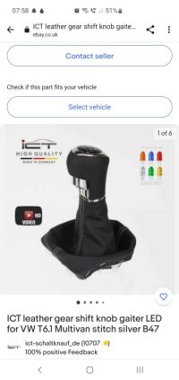

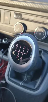

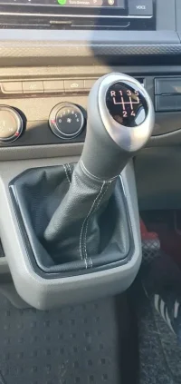

Definitely on my “I wish want this” list how easy was this to wire in?
Not too bad tbh, I removed the trim around the heater control panel and fed the wires up to the switches. To do this I popped off the passenger side vent, the end cover with the airbag switch on ( don't disconnect). Then the trim above the glovebox pulls out but is still clipped in on the rhs, no problem. The carefully prise out the trim which goes around the heater switches using a trim remover tool. Finally the heater control panel is held in with 4 push in clips which just need pulling out a bit ( you'll understand when you see them). Hope this makes sense!
Many thanks :thumbsup: Now off to source a knob:oops:
