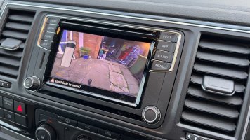

Set about continuing the reversing camera install with the new fish tape thing.
Sooooooo much easier - got the wire through tailgate, through the rubber grommet tube, along the ceiling, down A pillar then along under glovebox.
VCDS coding was straightforward and so was plugging in the loom with the canbus breakouts for the RCA and camera power.
Quite pleased with myself :thumbsup:

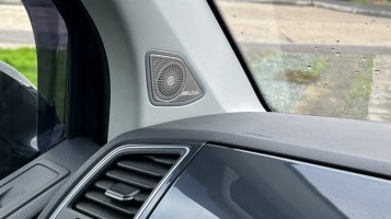

Have left the A pillar trim off because I will continue tomorrow when I fit the Alpine speaker kit. I also have some red footwell LEDs to fit too.

@t6blo happy with the speakers?
Yes, they sound good. I am getting on abit and am no audiophile but do like music to be loud and sound decent.
They are running off the standard head unit via CarPlay and I have the rear speakers enabled and these are a pair of 6x9 under the rear Kombi bench in a custom speaker/storage box.
