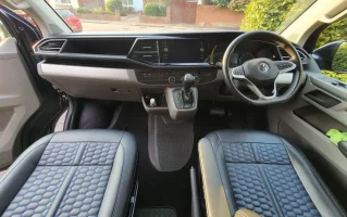

Well its been a year since I bought my T6, slowly slowly I've been converting her. All electrics done and to my surprise everything works! Still have bed boards to fit and need to find a water and gas supply solution as the cupboards are slim but I'd say she's about 98% complete!
First propper weekend away at santa pod this weekend..... euro top fuel finals.
Awesome job, looks great!
