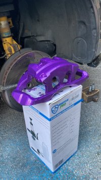

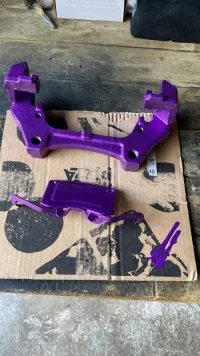

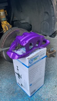

Made a start on my front calipers these past days, stripping the blue from the calipers is a nightmare. The stuff is like glue and has taken two days on and off to clean them ready for paint.
Efforts of my labour below, Cadbury purple.

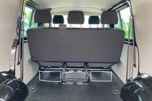

Attempted to start building the ‘under Kombi 3 seater bench’ storage thing. The space seems a waste and could be accessed from the front of the bench via doors/drawers for napkins, salt and pepper, plastic plates and camping cutlery etc for when we eat our lunch, picnic or make hot drinks. I also want somewhere to mount my rear speakers as I have bought a rear speaker loom from Slipknot. Also needs to house my AllPowers somehow.
Anyhoo, decided to cut a sheet of mdf for the floor and cut in into a sort of W shape so it would go round the floor mounts. Then cut pieces for the outer and inner sides. This is all very well but the floor piece only just slides in from the front at an angle and although easier from the back is still a faff due to wheel arches - there is no way I can build the sides of the storage boxes and then get it back in and I can’t reach all the places to screw it together with furniture blocks if I try and assemble in situ. This will also make it impossible to carpet properly.
Then I got too hot and sweaty and the sawdust stuck to my sweaty arms and legs.
Round 2 - I think I will just build a coffin shaped box behind the bench that extends to the middle load lashing points to fix it down, with speakers down low at the front firing under the bench and a compartment for the AllPowers. The picnic paraphernalia can go in a plastic box and be slid under the bench seat instead.
Starting to get cheesed off with my run of f’ing things up on this van - hope it’s not jinxed :whistle::confused:
