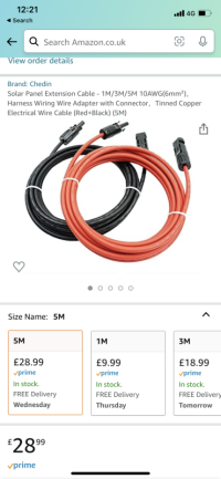

Very simple, as long as you have an understanding of basic wiring. I fitted Anderson connectors at the seat base to make it quick release, MC4 connectors can be a bit of a fiddle to undo in tight spaces. (Note: If using CTEK ensure your panel Voc does not exceed 23Voc)Is it that simple ?
Might be doing this soon
Voc is Voltage open circuit- basically the voltage measured across the output terminals when panel is in perfect alignment with sun in perfect conditions. It is listed in the panel specs.Do you have a link for the kit you've used ?
I have a Ctek 250se like you. Is it one cable one the Ctek then fit the Anderson connector on the end ?
