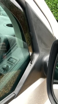

I’ve sent you a pic of my fixing!Smoky Climair's are looking great @JOG. I need to have a word with myself, just order a pair and get over the fact I need to tap a couple of teeny tiny holes to fit 'em. Did you drill pilot holes or just use self-tappers to attach them pal? If you could PM me with the pix shared by @Skyliner33 and @Texxaco I'd be massively grateful (as long as those two gents are happy with that of course)...
They come with tiny black screws. They are really small, look bigger in the photos. I think its a 1 or 2mm hole, i drilled mine and put a dab of black roofing sealant before screwing on gently by hand. Leave the impact driver well aloneSmoky Climair's are looking great @JOG. I need to have a word with myself, just order a pair and get over the fact I need to tap a couple of teeny tiny holes to fit 'em. Did you drill pilot holes or just use self-tappers to attach them pal? If you could PM me with the pix shared by @Skyliner33 and @Texxaco I'd be massively grateful (as long as those two gents are happy with that of course)...
1mm pilot and definitely screw by hand!They come with tiny black screws. They are really small, look bigger in the photos. I think its a 1 or 2mm hole, i drilled mine and put a dab of black roofing sealant before screwing on gently by hand. Leave the impact driver well alone![]()
Thats the one, one product the instructions were actually some good of1mm pilot and definitely screw by hand!

The climairs? Very straight forward. When in, I just pushed the lower part (that takes the screw) in with my thumb so that it is “centred” on the plastic before drilling. (See pic below) As above, don’t over drill it as the screws are very small.How easy are they to fit @JOG ?
