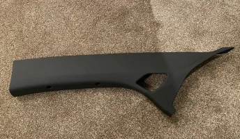

Which BLAM did you go for?Got some new BLAM speakers with tweeters up front to fit. So ‘A’ pillars off and thought I’d start a re-trim as well whilst they’re off.
The 20cm kit from Skipton Car Radio. So a tweeter upgrade for the front and 8” drivers for the doors. Should be good.Which BLAM did you go for?

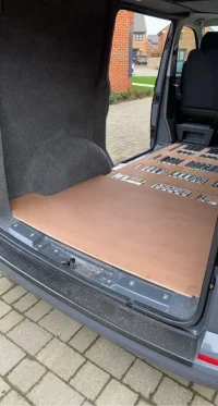

Hi @Stuiemc, no need to cut the biscuits, just get used to eating them whole.Got more done to the floor. Trimmed floor, cut biscuits, cut and stuck down the insulation and re marked the batten locations. The 20mm screws I bought were too small, need 25mm screws and cut the tip off.

Or dunk them first!!Hi @Stuiemc, no need to cut the biscuits, just get used to eating them whole.
Haha I’ve got to disagree! There was a lip where the two pieces join and after they sit completely flush with each other. Well worth the extra 20 mins it took to put them in. I’m fitting a Karndean parquet floor so don’t want to run the risk of the floor flexing at the join.Hi @Stuiemc, no need to cut the biscuits, just get used to eating them whole.
That does seem to be the best outcome.Haha I’ve got to disagree! There was a lip where the two pieces join and after they sit completely flush with each other. Well worth the extra 20 mins it took to put them in. I’m fitting a Karndean parquet floor so don’t want to run the risk of the floor flexing at the join.
Yeah I’d love to see it, lucky guy finding a sheet of 10x5” I couldn’t for the life of me find a local supplier that stocked them! I’ve put a photo in my last comment that showed the lip before the rich teasThat does seem to be the best outcome.
I fitted a floor in my van this summer using 10’x5’ 12 mm phenolic plywood and am also very happy. Just finished making wheel arch boxes with storage space through a lift up lid. Can post a photo if your interested. It’s a panel van though, not used for camping etc
I will upload some photos by the weekend.Yeah I’d love to see it, lucky guy finding a sheet of 10x5” I couldn’t for the life of me find a local supplier that stocked them! I’ve put a photo in my last comment that showed the lip before the rich teas
