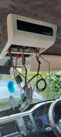

Fitted battery isolater switch (in place of relay) and swapped tidied some wiring up. Voltmeter now wired up to a momentary switch instead of on all the time, those combined seems to of cured the parasitic drain on the leisure battery.
