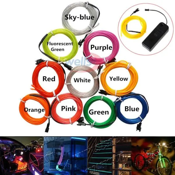

I like them, were they in line LED‘s or are they LED rope? Be interested to know where you sourced them from.
Where did you draw the power for them @Andysmee?
It’s electroluminescent wire rather than LEDs, different technology and needs a different power source.
£1.38 25% Off | 2m/3m/5m LED Neon Light Flexible Glow EL Wire Rope Tube tape waterproof use for Shoes Clothing Car Decorative etc
Thanks @andys , how are you going to power them as the look like they are battery powered in the link?
(Too many andys!)
I don't remember where I got my EL wire from, it was left over from a project years ago. I drive the transformer module directly off the ambient feed, in fact I took it straight from the back of the dash dimmer switch and run across to the passenger side. It's only about 1.5m long
I'm going to do a write up when I move the puddle lights to the courtesy circuit
Mine are run from the electric window wiper circuit. Work a treat.
so the EL rope are 12v, happy days, that’s me ordering them too.
They’re not 12v but the transformer that connects to them accepts it. You will need a separate transformer for each separate string. The wire is fiddly to solder to.
Think carefully where you put them, see YouTube for some real horrors.
