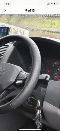

I’m purchasing a 07 t5. The speedo clocks missing a temp gauge. Obviously a very basic model. Is it as simple as swapping the clocks out to a set with the temp gauge ? Is it plug and play for it to work ? Don’t think I can look at them clocks looks a little bland.
