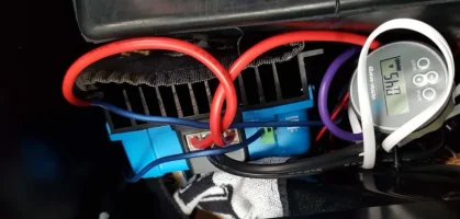

Hi everyone I have installed a Victron disc charger into my 2018 t6
I’m having a nightmare setting it up, and cannot get an output charge from it
could someone help me with set up?

install is just power in from main battery. Earth cable.
power out to AGM leisure battery and earth.
using the app to monitor it.
currently just have the default settings in the app

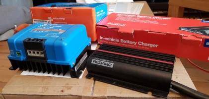

heres mine . .
