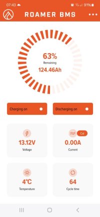

Yes but here is a screenshot of my battery capacity a while ago, which also shows 13.1Volts, but with available Ah showing a healthy figure. What is your available Ah on your batteries?
