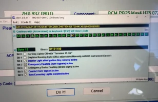

However I did find this below. Anyone know what 'DRL adjustable manually and/or instrument cluster' means? I tried switching this on but made no difference I could see.
Presumably puts a DRL ON/OFF selection into MFD. However, doesn't seem to work on T5/T6. There are a few mentions about this somewhere in the Forum.
Yes different part number will have a different label file so it’s possible that byte is just not documented for your BCM (also possible it’s simply not there/won’t work)
