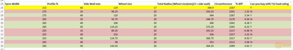

Folks, have just picked up my first van and eagerly trying to choose some alloys and figure out what tyres I need. Van is a T32, so have quickly discovered the limitations around load rating, wheel width, offsets etc.
To try to get my head around the tyre options I knocked together a little spreadsheet which compares the stock 17" Highline wheels and their 215/60 tyres vs a 20" wheel with different widths/profiles. My objective was to get to the best balance of -
1) Choosing a tyre that looks good but doesn't turn the van into a boneshaker
2) Trying to match the width of the tyre to the equivalency table that @StudleyGlass posted above
3) Trying to minimise misread on the speedo.
Here is spreadie -
The stock 17" wheel/tyre is shown in yellow. Any tyre width that doesn't appear to be sold (I only checked BlackCircles) with 103+ rating is red, so that just leaves the green rows as possibilities.
Based on my criteria above, the 265/40 appears to be the clear favourite......the profile looks good given that its slightly lower than 275/40 (which seems to be widely recommended) but not so low that its uncomfortable. The mis-read on the speedo is the best as well (under-read of about 4.4%) compared to the other green rows. And lastly the 265 width appears to be closer to what is recommended for rim widths of 8.5 or 9 (which I believe most 20" rims have). I'm also thinking that a 265 tyre presumably is gonna give you slightly more leeway when it comes to wheel arch rubbing concerns?
That leaves me wondering why do lots of people seem suggest going for 275/40 rather than 265/40 when on the face of it the 265/40 appears better on a number of fronts? Am I missing something?
