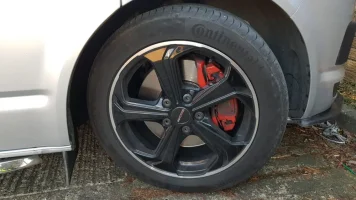

FWIW:
here is a few pics of the front Vanco Conti - fitted from New, just done 10K so have a few K`s left on them.
50PSI all round (from new) T32 PV (running heavy) with FWD + DSG.
its a firm ride with the stock sportline suspension, but if i run lower pressures with the weight, the van gets all soupy in the bends and the rims can bottom out in pot-holes + speed ramps !
View attachment 37872 View attachment 37873 View attachment 37874 View attachment 37875 View attachment 37876

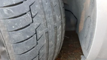

Hi, sorry to bump this but hoping for some tyre pressure help.
I have a 2013 T5 startling Kombi that has had Sportline alloys fitted. The tyres are 255/45 ZR18 103Y XL with a load rating of 875kg, BUT it says the maximum tyre pressure is 44psi.
Looking at the recommended pressures this would suggest that running unloaded I would have to be using the max pressure, at least on the front. Can this be right? If I ever want to use it for carrying larger loads (I got it as a day van and in process of converting, but also wanted to be able to use it for transporting furniture and building supplies etc) will I need to get new tyres?
Thanks in anticipation!
Yep, it's saying max pressure 44psi. Would a car have a load rating of 875kg though? We bought it from the local independent VW specialist (it was his personal van) so kind of assumed it would be pukka. Photos for reference:Hi.. So to understand is it printed/embossed on the tyre wall max pressure 44psi. ( on my Michelin tyres it states 50psi ) Photo would confirm…so id contact tyre dealer as you may be on car derived tyres and not van Xl tyres
