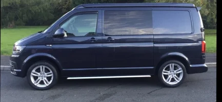

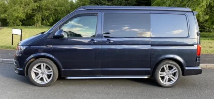

I had a similar problem with my T28 with full camper conversion sagging at rear. I wanted to balance ride and although not a priority, I was also interested in a subtle drop in suspension height. Didn’t want to spend out on B14’s etc and wanted to avoid fitting sports springs alone. I went for Eibach comfort springs 1 supplied by Chilli Jam Vans. Just had them fitted and really pleased with result. Van rides really level and I am pleasantly surprised by quality of ride and the van definitely handles much better. I have attached photos before and after. Van is 2017 T28 Highline- 150hp.C05D0D2F-57F9-446E-83A0-9A051D759D44.webp68F5CBF3-FFAA-4DBC-A647-EAE2742E3C62.webp
