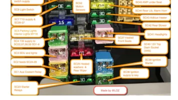

I've had this T6 for about 5 months now. Whilst driving last month It suddenly acted like the key had been taken out the ignition, lost engine, MFD, power windows e.t.c only thing left working was hazards, headhunt, interior lights, stuff that still works with no ignition. Breakdown found a 10A fuse in slot 26 to be blown, suggesting it was for the body control module. Replaced with another 10A and then it was fine for 800 miles, until it did it again today out the blue. Again fuse 26. Replaced and it's working again. I can't work out what is causing it to pop, the fuse diagram on this forum suggests it's rear wiper / washer but the Haynes references the AA used said it was control module. The suspicious piggy bagged fuse I can only assume is for the 12v socket in the back that was an aftermarket install years ago.
worth noting these issues only started after the door speakers were replaced, but the electrician who installed them said he didn't go near the fuse box, they are direct replacements no amp. Image shows the fuse that went. It's a 2015 T6 t28, not sure if that makes a difference.

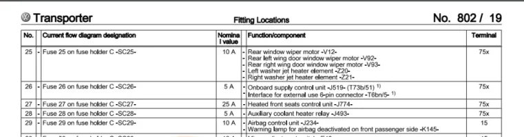

further info. The fuse card document on the VIP section lists fuse 26 as:
- Onboard supply control unit -J519- (T73b/51) 1)
- Interface for external use 6-pin connector -T6bn/5-
J519 seems to be the body control unit? it also lists it as a 5a fuse, so not sure what a 10a is doing in there. Anyone else had this issue?

The reason it says BCU is because a number of items are controlled by the BCU but the system it is controlling has its own supply fuse.
there are normally smaller fuses for the control switches that signal the BCU then the BCU switches the output to the consumer feed by an appropriate size fuse.
Fuses can be sized different depending on the options fitted to the van. The fuse card is based on my 2016 California as it has nearly all the options you can have so as complete as I could get it.
I’ll have a fresh look at the diagram as there are variations.

Yea on your earlier model you have fuses in sc21 and or sc26 where mine(on the card ) does not.
if you use the fuse part of the circuit diagrams page 669 you’ll see all the circuits that are linked.
there are some joints and it is basically the supply for running and starting.
