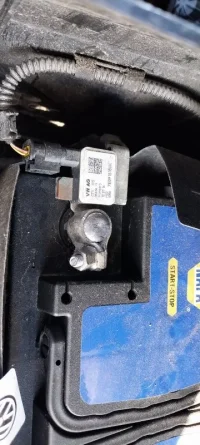

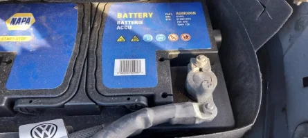

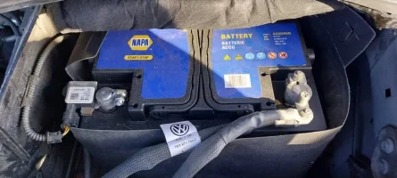

post a pic of your starter battery connections. . .
this is normally down to incorrectly installed kit in your van wired to the battery NEG post.
