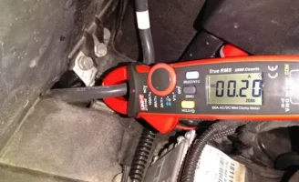

I did duplicate the above except disconnecting the battery negative. Measured the current using a DC-clamp meter over battery negative cable (checked the zeroing of the meter quite a few times).
- Unlocked the van, opened driver's door, opened the hood, closed all the doors, radio and interior lights were switched off
- Fluctuating current flow of several Amps
- After approx. 40 seconds (of shutting driver's door) the current stabilizes down to 0.5 A.
- At 5 mins current drops down to 0.2 A
- At 15 mins - current 0.2 A

@mmii do have a (Cheap) clamp on meter but it only reads to 0.1 amps, looking at your meter I'm taking that your reading showing is 0.2 amps or 200ma? I was expecting lower than this (from tutorials etc online) but these are shown on older car models so dont know how accurate they are? I will try the same test today.

@mmi I've just carried out the same test using the clamp on meter, after 5 mins & 15 mins with the bonnet latch closed and after locking the van it drops and hovers around 0.1-0.2 amps, so similar readings to yours.
True - that's the current for an unlocked T6. Checked a bit more last night. When unlocked (but all the doors and the bonnet shut) it does not go any lower.
That's interesting - when van is locked with all the hatches shut it should drop below 50 mA (in a few minutes - VW spec). Mine is approx. 35 mA. The bonnet latch was "closed"? Certainly could be that the current is now at edge of the resolution of the meter (just the last digit "fluctuating").
The DC clamp meter in the picture is a cheap one UNI-T UT210E. I used 20A range. It has also 2A range.
