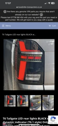

Travelin-lite T6.1 LED tail lamps
Few comments up there is a link dopeytree has put up already.
And yes the indicators are Sequential
They do them for standard halogen lights and led rear lights.
Think there on preorder now as there out of stock until march
Cheers.
These are the black smoked ones from THQ.
