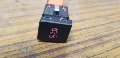

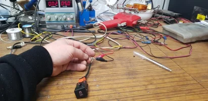

Traction Control - ESC/ASR & HDA switch retrofit
Thanks Ray.
Would you mind to post wiring diagram as I want to retrofit this switch?

i didnt work out coding yet
if someone with a T6 which has the button already could post a scan it would help
I'm interested in this little mod too.
I take my van off road (fields) with my trials bikes and I've found in the past that turning it off helps.
Hope someone can help with the coding?
