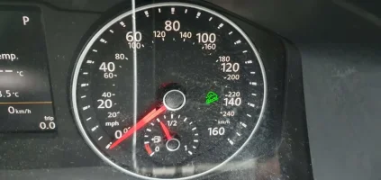

In my case there was only need to run 2 wires(blue/white & yellow) to the ABS unit.
I presume grey wire (feedback to HDA switch indication light) is required only
for lower range instrument cluster without green HDA indication light.
Probably, but there is no way to get that indicator in the Switch to be illuminated via that Grey Cable from ABS.
In 2019 Scematic VW removed the grey cable.
You are right, I was curious and I ran that gray wire to my HDA switch and as you can see in my previous video it doesn't light up.
So, is this green indication light present in all types of instrument clusters?
Reactions: mmi
Another interesting thing I have noticed is the following.
When I switch ON ignition only and I press traction OFF switch I am getting "traction control deactivated" message on its own in my instrument cluster.
But when the engine is running I am getting the same message followed by "front assist not available",
so, as you already discovered, engine control unit is a very important element of front radar system setup.
Reactions: mmi
