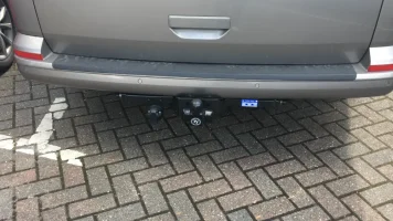

IMG_2991.PNG Mine is a tow trust bar
Only use it for work so not bothered about the look and it make the bumper feel more solid . I just need to get my reversing light back on it
