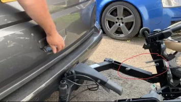

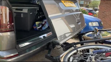

only issue I faced was my own doing in not reading the manual and not puting the safety release cable on the 2nd notch to allow the tailgate to fully drop open with all 4 bikes still attached
HelloRS6+ I had a Velospace XT3 and it wouldn't allow the (T6) tailgate to open - I thought it was a towbar neck issue on my Westfalia removeable but I may have been a numpty and got it wrong. I tried and tried but couldn't get it to work and sold it. What tow bar do you have please?Sounds like it may be a wiring issue on the towbar.
I’ve just purchased a Thule XT3 with 4th bike option as well but have a factory fitted tow bar and everything works as expected
I have the westfalia removable on mine and no issues with the XT3 on the second cable notchHelloRS6+ I had a Velospace XT3 and it wouldn't allow the (T6) tailgate to open - I thought it was a towbar neck issue on my Westfalia removeable but I may have been a numpty and got it wrong. I tried and tried but couldn't get it to work and sold it. What tow bar do you have please?

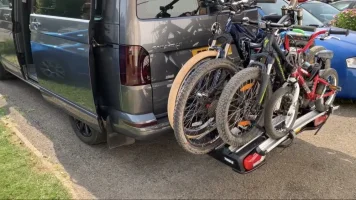

Both racks are possible, but you can only use the lower rack for 20" wheel bikes.... or other non-bike itemsAHHRG. Maybe it was the cable notch I didn't alter; I remember feeling like I needed to alter the angle of the socket on the ball a tiny bit but couldn't.
Thank you very much for your reply... That photograph answers another question "are both racks possible?" BRILLIANT
Fantastic. Thank you for taking the time to post. Super helpfulThis is the clearance you get with all 4 bikes attached and the safety cable moved to its maximum notch setting
