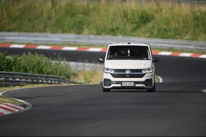

I took mine on the ring. Handled it really well! Solows are a must! I was running a Accelera Phi 225/40/20 here and had no issues with grip. Weight is a massive factor, and even though I wasn't going that fast, you can certainly feel the weight going into and out of corners!
Were planning Germany and Alps trip next year with MTB's and I really want to get mine round the ring at the same time. As with any track stuff the brakes will be the most important bit so make sure they are up to the job first.
Id say a good 18in set up is probably best compromise for the wheels / tyres. Maybe some uprated ARB's as well. I find mine handles surprisingly well with the H&R coils on.
