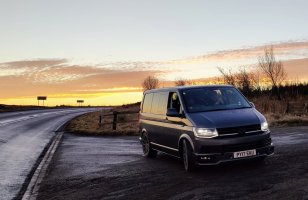

Team Indium Grey
Looks spot on! Very nice

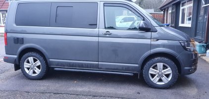

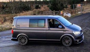

What wheels and tyres do you have on the van?
Standard suspension?
@GJ_Davies Thanks! The van is on 17" Black Rhino Overland wheels with Pirelli Scorpion AT+ tyres - 225/65/17. I could have gone a bit wider on the tyres (235) but stayed fairly safe (for now). The suspension is just about standard ride height (slightly lower) using T32 springs at the rear (to level the stance). I replaced the dampers with Koni Special Actives and updated the ARBs to H&R. All suspension work carried out by Steve at CRS Performance.
I may go a bit lower in future but for now I wan to see how it copes with the Highlands in winter. It's super comfy to drive, even SWMBO noticed the difference.

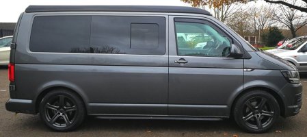

Post a pic when you get the bronze wheels on please, I'm thinking of doing the same. Cheers
Hi @AK06FR here is a previous photo of when I got the bronze wheels fitted:
