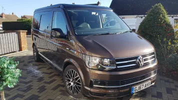

Thanks mate,only had it 2 months and it's been lowered on bilsteins with 20"bbs wheels, front splitter added rear sportline spoiler,windows tinted and colour coded engine cover and had a full ceramic coating and 2 hydrophobic coatings plus all seats and carpets waterproofed.
She is a lovely bus with plenty more to come

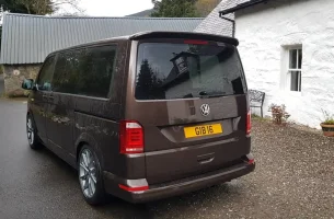

Got to keep Chestnut Brown near the top of the pile, this is a more recent shot of Agnes Brown our camper, apart from B14s and H&R Arbs underneath the changes have been mainly an infestation of bling!

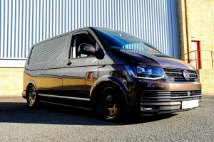

When the solows were fitted did you have the bumpstops cut down and Abs line moved?
How far are the solows wound down and how’s the ride?
Hi, Looks so good.
Thanks, it’s certainly getting there. ABS lines were moved to avoid crushing, but bump stops weren’t modified yet.
SoLows are wound down all the way at the rear and are 5mm from bottom at the front so not to let the adjuster seize shut. Stage 1 hub mod was done too and skimmed top mounts. The ride is impeccable, not crashy even with 20” on stretched tyres, although I do get a little drive shaft shudder on heavy corners due to ride height.
The next step is to go a slimmer tyre on the rear and add the adjuster deletes to gain about 20-30mm drop at the back, then do an extreme hub mod at the front following a subframe and engine raise, as the frame at the moment is about 40mm off the floor so would be unusable if it was dropped further at this stage. This will also solve the drive shaft Issue too.
Funny how to drop approx 150mm is relatively easy, but that last 20mm is a whole other level!
The next step is to go a slimmer tyre on the rear and add the adjuster deletes to gain about 20-30mm drop at the then do an extreme hub mod at the front following a subframe and engine raise, as the frame at the moment is about 40mm off the floor so would be unusable if it was dropped further at this stage. This will also solve the drive shaft Issue too.
