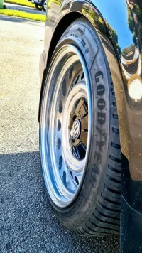

So my new wider banded Amaroks turned up last week and are now fitted. Going 9.5 rears is only possible when running really low on a static set-up if you slightly stretch the tyre. Running what most run on these wheels, 255/45/18 won't work because it will just catch and rub the inner liners like crazy. So i've gone for 235/45/18 all round and the rears sit absolutely spot on.
On the tyre note, I was running Michelin CrossClimates, but decided to go for Goodyear Vector 4's on these latest wheels, due to not being overly impressed with the initial traction in the wet on the Michelins, however.... The Goodyear are exactly the same, with my traction light flickering on and off under throttle in the wet, all the way up to 3rd gear, so i'm going to blame the Revo and TVS for this, though it's not a complaint i'm going to moan about for obvious reasons:devil:
In fairness to the Michelins, they are actually quieter than the Goodyears, but I prefer the look of the Goodyears.
I know it's hard to tell the difference between 9" rears and 9.5" but that extra half inch added to the dish makes a huge atheistical difference on mine and it's exactly what I wanted, so i'm chuffed to bits with Jamies work yet again. Also worth mentioning that all but 1 wheel needed no weights to balance, and the single wheel that did, needed 15grams, which is testament to the quality of the banding work, plus obviously good quality tyres.
Following you round on the forum... :whistle:
you know my thoughts on your van and the banded steels look! Looks fantastic.
I’m going to say it and I know everyone is going to cry about it... but those tyres look so much better stretched with that profile. Also the edge of that rim sits lovely on them!
