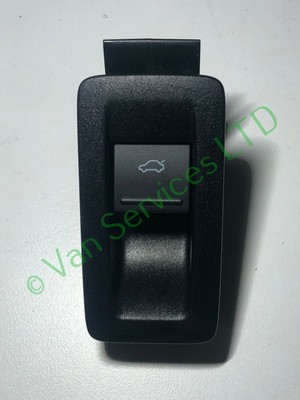

You’re not going to like the price...

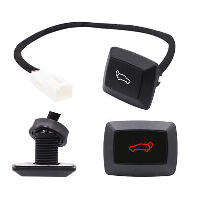

I have seen that one. But it would need a dedicated VW plug/connector.
I have already tried adapting one of the dashboard switches in a spare slot to make a switch for another purpose. But I had to cut into it with the dremmel and then solder onto the tags. So not ideal.
I actually think a cheap spring loaded ‘normally closed’ switch would do the job. Be easy to wire. And probably cheap as chips.

TPS are worth a try. Or the eBay offering above.
Yeah! I got an original one at a similar price and then needed the outer bezel to finish it off and that was another £15 all in! It looks good though.
I fitted one of these
Same. Took the feed from the numberplate light and job’s a good’un.
