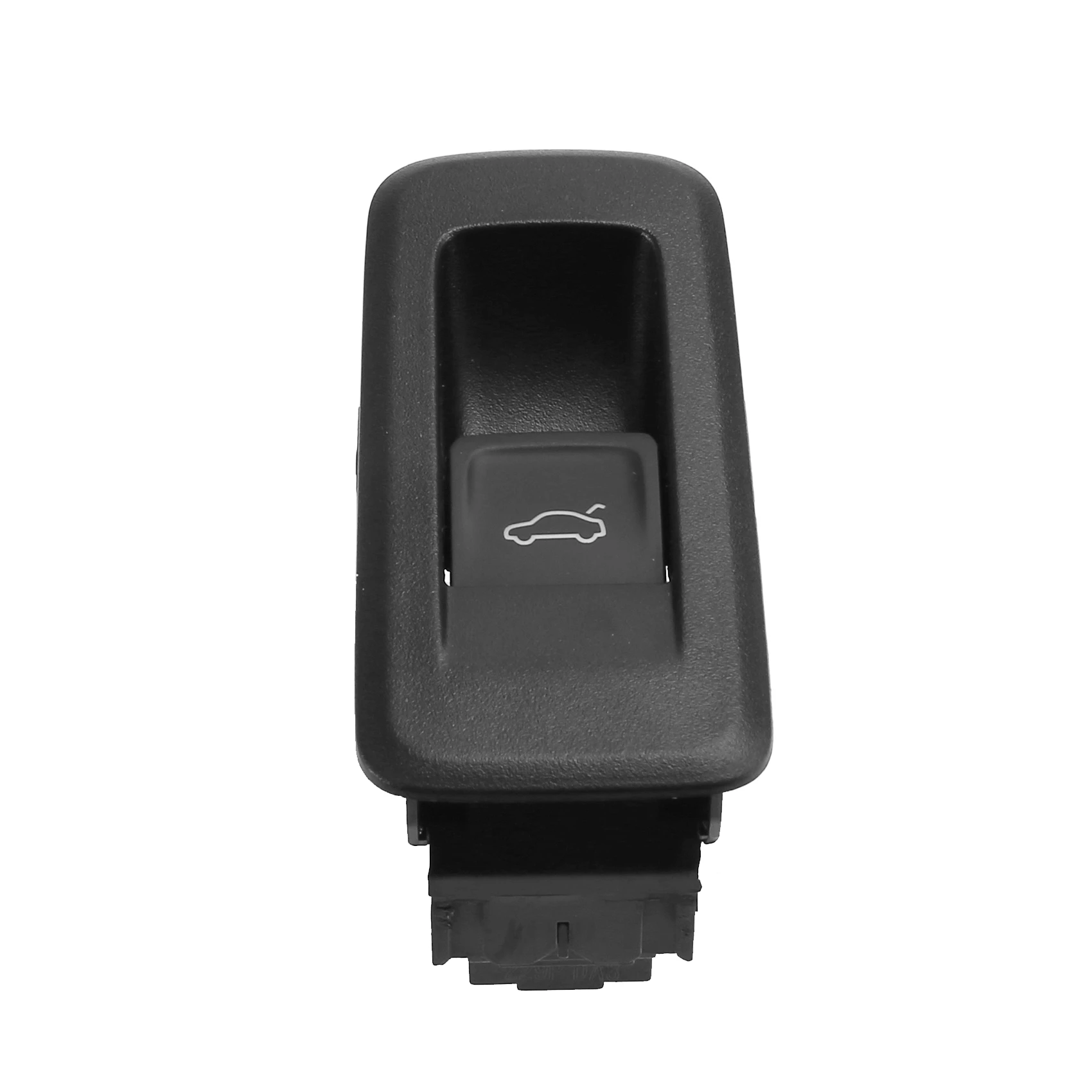

If anyone wants to do the OEM route cheaply, I just bought this on AliExpress:
I just found this on AliExpress:
Electric Tailgate Switch Button 5GD 959 831 5GD959831 For VW Tiguan MK2 ID.6 ID.4 Passat Tharu Lamamdo
It's for a Tiguan, and the button is the other way around, but I doubt anyone is actually lifting the tailgate by the switch anyway. It comes with the surround as well.
It doesn't appear to have a 180ohm resistor inside (unless it was hidden), and the Pins to bridge are 1 and 3.
