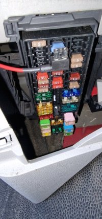

Hi I blew a fuse to my interior lights and tail lights, changed fuse and no won't work and also been to garage as its saying terminal 30 open circuit.
Also horn doest work either
Please help
This is the fuse that will have blown. 7.5a 5th fuse up LHS. If you've been checking the fuses make sure you've replaced them in the correct place. Have a close look at the fuse slots. If you can see a metal terminal on BOTH sides then there should be a fuse in there.
What about the rest, did you remove any other fuses?
Can you post a pic of your fuse box?
What caused the fuse to blow, had any work done on your van?
Looks like a fuse missing. LH column green 30a is wipers, below that should be 15a tail lights and below that 30a horn,
Looks like that slot is empty. Can you confirm if there is a metal terminal both sides in that slot?
No can't confirm, can you send pic with arrows of what should be where please e
