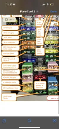

I’m still trying to get my head around the t6 fuse box locations and in particular the rear tail light drivers side fuse.
Any links or help please?
If you search the forum for "tail light fuse" there are several threads regarding the location of the (single) fuse, which is also annotated on the picture linked above.
There are also some unusual faults that seem to affect the tail lights, such as the interior light shorting out. There are a few listed and well worth a read if you're having problems.
All rear sidelights (and interior lights) are fed from fuse five on the dash fuse box counting up from the bottom left
