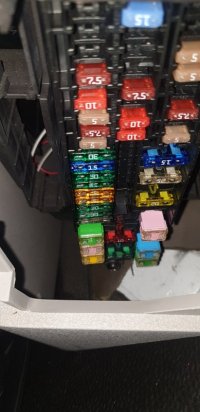

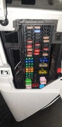

Rear passenger side lights not working stop lights and blinker works but the red normal lights i cannot find which fuse it is to check fuse i replaced bulbs can i get a diagram of a fuse box of a T6 transporter 2018 model i removed couple fuses and now im thinking i put them into the wrong slots cause now the front light not working is attach fuses correct slots ???and which one is for the left hand lights or is both left and right connected to same fuse any ideas will help thanks

If you're not sure if you have fuses in the right place have a good look in the empty positions, ideally with a good torch.
"Meant to be empty" positions will either have no terminals or a single terminal (they tend to be bus bars)
"Meant to be full" positions will have both terminals.
Tail lights are likely the 15Amp in the top left hand row of your picture - and that looks like the right position, though tricky to tell at an angle.
That would be the one to test if you have a multimeter or replace with a known good one.
Is it possible to get a clearer picture of the bottom of your fuse box?
