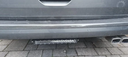

Did anyone tried fitting under the bumper small lighbars like the one below on the photo? If yes, how did you do the wiring? I am considering fitting 2 of those lightbars in slight angle outwards but not sure with wiring. I have a tow bar, so this is one option and second is to connect straight to original reverse light. What is your opinion?
Sweet. Have you got any photos how it look like and where did you fit it to?
Couple of photos here. The second (not so good) photo shows the light bolted to a 1" x 1/4" flat bar the I secured under the bumper and the fitted the light central to rear of the van.
Hope this helps.
