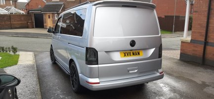

Cheers, I’ve already had a look at Travlin Lite and yes, they are out of stock for the red ones but have the black version available on sale at £250. Not sure about the look of the black ones so might wait for the red ones to come in stock. Mines a tailgate in reflex if anyone else has the black ones to show how they look/ perform.

These are the THQ led black lights with fog and reverse on both sides. The only way to get both sides working as your van has halogen, is, as said above, to wire across from the offside to near side light. If you fit the led lights you’ll also need to replace the plugs as they are a different fitment.

I had halogen. To fit the led units the connector plugs need changing as they are different. To get the near side lights to work requires a hard wired link from rev/fog on the offside connector running across the van to the nearside connector. I got the plugs with loom from @Pauly but I don’t know if he still does this as it was a few years ago.
