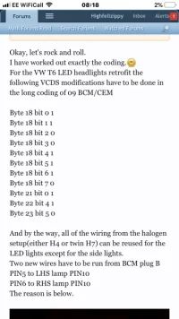

Anyone got coding for high beam side I’ve used the list on this forum
But no high beam as yet
Both of the above are actual links to be clicked on;)
Reactions: mmi
Can you confirm that your coding and wiring is as described above?
Reactions: mmi
Byte 18 bit 0 1
Byte 18 bit 1 1
Byte 18 bit 2 0
Byte 18 bit 3 0
Byte 18 bit 4 1
Byte 18 bit 5 1
Byte 18 bit 6 1
Byte 18 bit 7 0
Byte 21 bit 0 1
Byte 22 bit 2 0
Byte 22 bit 4 1
Byte 23 bit 5 0
Reactions: mmi
